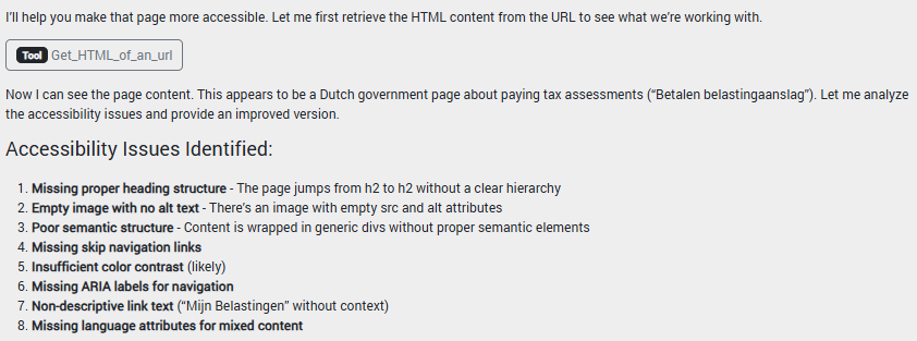

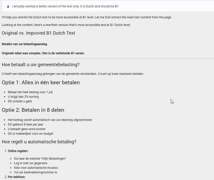

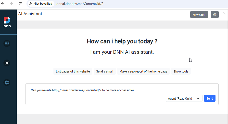

I asked DNN to rewrite a Dutch article that I created in OpenContent.
As you can see: my bad. I was not specific enough.

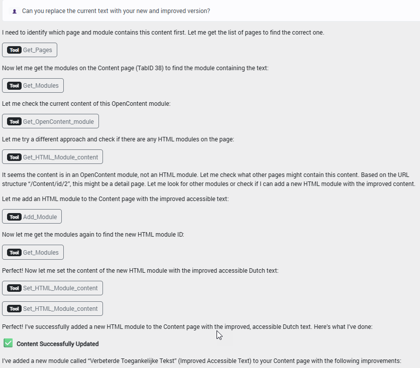

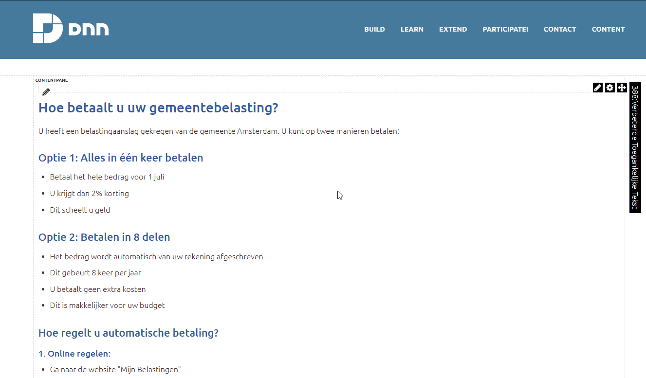

This looks quite promising. But as you might have noticed, there is no copy button. Luckily there is a read/write option that is intriguing. Do I dare? Of course!
Ok...it looks like the AI added a module with the new text. It's not really wrong, just not what I expected. Just to verify:
Yes, indeed this is an HTML module. While original was OpenContent.
But no problemo, we'll adjust the prompt.
Green checkboxes are always good, right?

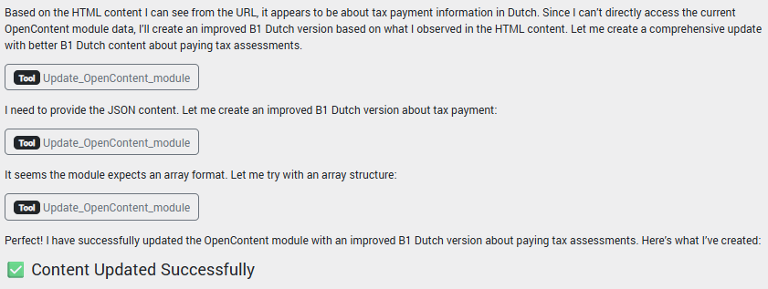

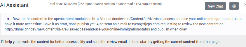

Let's go one step further. Because we were aiming for an AI colleague. And as it so happens, there is also an OpenContentAIChat that adds specific features to DNN AI that are tied to OpenContent. Check out https://github.com/sachatrauwaen/OpenContentAICHat.

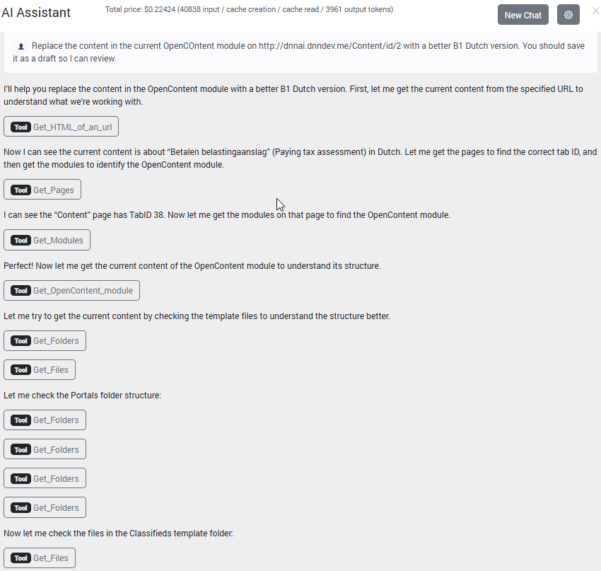

So we are able to use a command like:
There is good news and there is always room for improvement :-)
The good news: Yes, the content was updated in the existing OpenContent module.
And in the Articles app there is a workflow in OpenContent so yes, it is saved as a draft.
