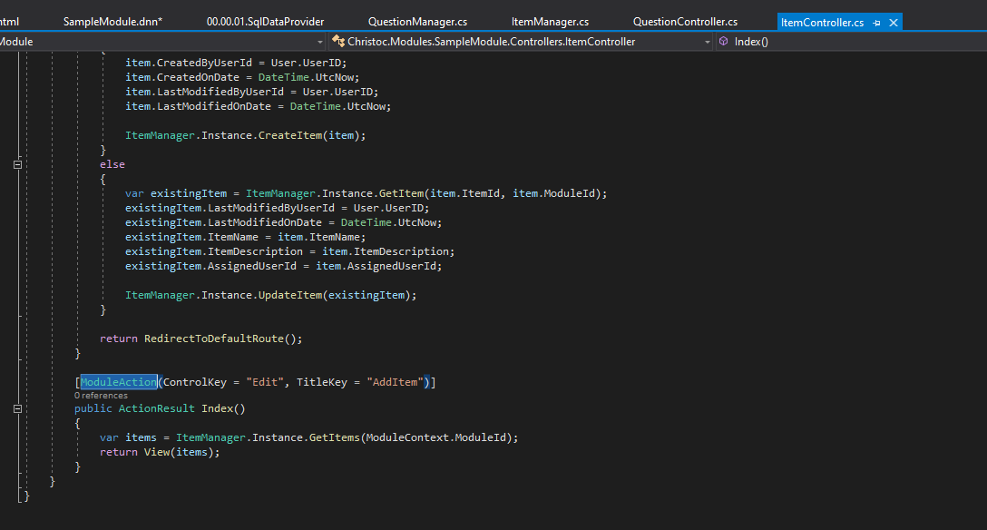

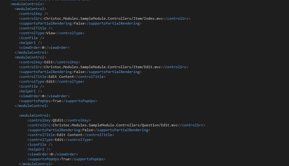

hi,i want to develop a module by mvc template, i 've reade some documents but i didn't understand how can i add multiple actions to Module Action Menu, please guide me ..thanks

First a disclaimer - I have not used this template - so it is pure guesswork from here on ;-)

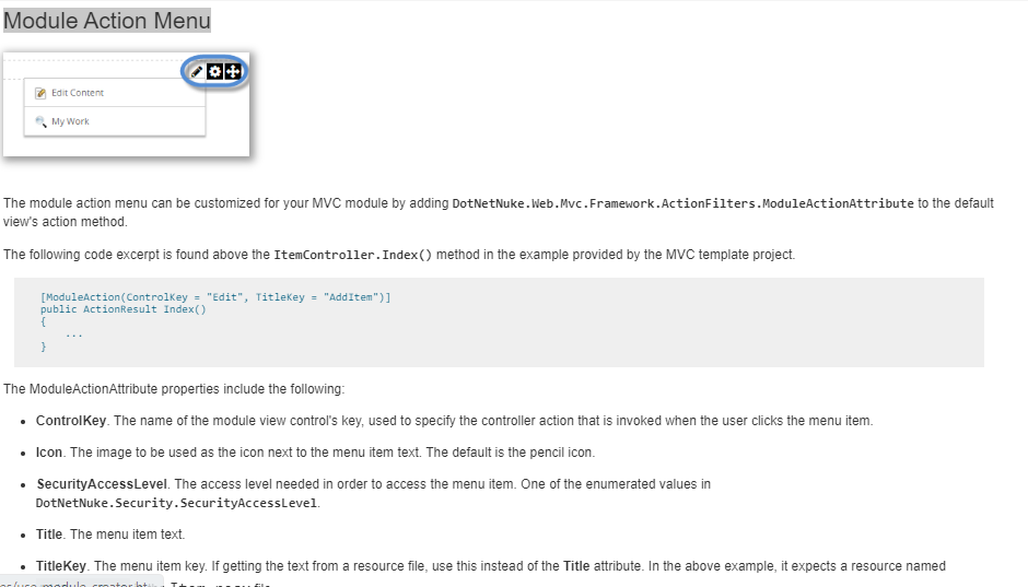

Based on the code snippets supplied it seems that you are almost there, and all that is missing is changing the TitleKey attribute to a Title attribute. The text explaining the TitleKey attribute is cropped, but using the same as the example could perhaps cause conflicts - or maybe it is not found due to the altered controlname causing it not to be found and thus not added to the list?
Try using the plain text attribute first (TitleKey) and if that was the missing piece you can switch to a text from resources to have multi language support.
