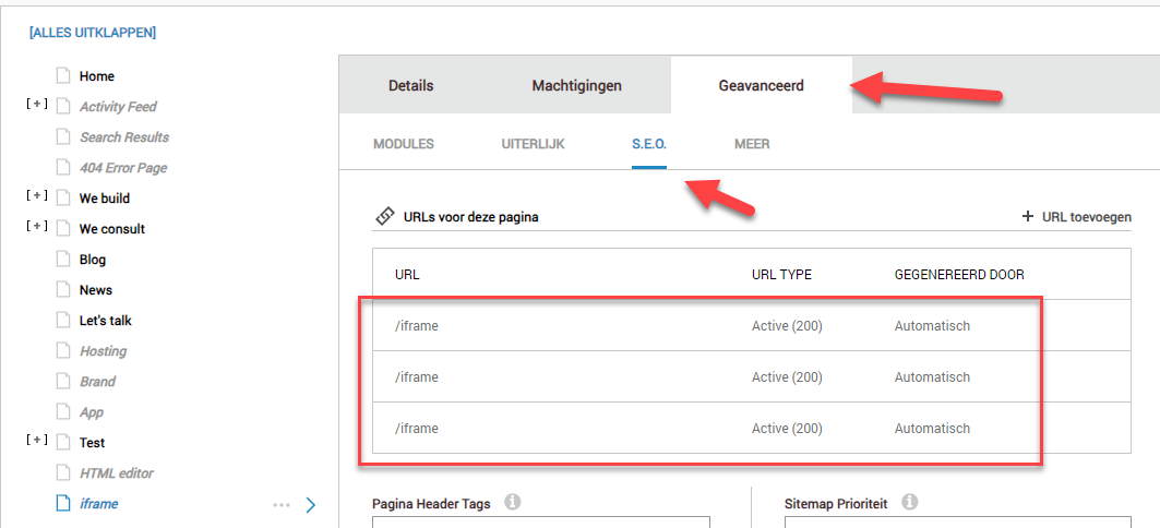

Could you check the SEO tab? You might have (many) urls there because pages have shifted around in the siitemap, renamed etc. This can sometimes lead to too many redirections behaviour. After deleting old urls, restart the app (clearing the cache) and try again.
