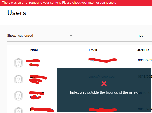

Hello all !
I'm new in the community but I've been using DNN since 4 years in my organisation.
Recently, I'm facing a bug that I'm not able to resolve alone. That's why I'm asking the community for help!
When I'm logged with the superuser account with all admin rights, and I want to search a specific user in the Users list, I'm facing a bug telling me : Index was outside the bounds of the array.
Do you know how to fix this bug?
Thanks!
Best regards
Ben

Thanks for your anwser and sorry for the delay. We are using the version 9.1.1
Our DNN is regulary down and we reset IIS each week at least. The issue is still here
Any other ideas?

Dnn4Less have now upgraded my sites to 9.13.7 and the issues appeared to have been resolved.
However the underlying issue of Search showing errors in the log still happened.
To resolve this i did the following;
1. In the Scheduler I added the VPS server name into the Search Site Crawler parameters
2. Clear the site cache
3. Restarted the site
4. Checked this had worked by looking again at Settings|Search|Basic Settings and instead of the previous error of "There was an error retrieving your content. Please check your internet connection." I got the settings displayed.
