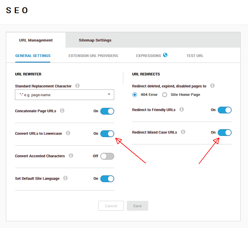

For those ending up on this thread through google:
In newer versions of DNN (this is 09.13.07) you can use these options:
DNN SEO lowercase characters
The first one converts the urls in the menu to lowercase, the second redirects any incoming urls to the lowercase variant.
HTH
Nice! We had a client enable and use these settings recently.  I've honestly not gotten huge gains from these settings in recent years.  Google seems to be more than capable of figuring out the difference.  However, after going through that recently, I realized that you can also break various features/modules when changing these settings.
If you modify these settings, be sure to check all mission-critical features on your site.  If your custom/third-party extensions aren't taking these settings into account, some features may break.  (I'm not telling you to not do this.  I am only telling you to be sure to test thoroughly after applying the settings.)
