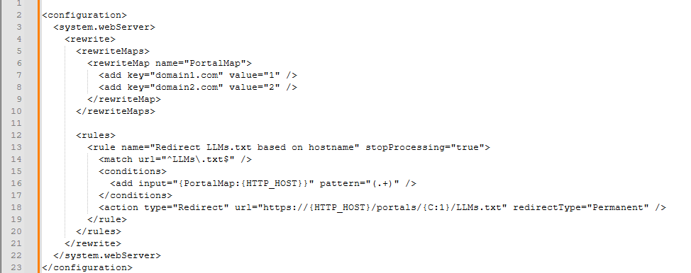

Hi all
SEO has been part of our game for a long time, now GEO. So, optimization for generative AI like Chatgpt, Deepseek, Gemini etc.
For this, one needs to upload a LLMs.txt in the root folder. In a regular setup not a problem but in e multi portal setup: how do you do this?

Something like this in IIS should do it:
<code><configuration> <system.webserver> <rewrite> <rewritemaps> <rewritemap name="PortalMap"> <add key="domain1.com" value="1"> <add key="domain2.com" value="2"> </add></add></rewritemap> </rewritemaps> <rules> <rule name="Redirect LLMs.txt based on hostname" stopprocessing="true"> <match url="^LLMs\.txt$"> <conditions> <add input="{PortalMap:{HTTP_HOST}}" pattern="(.+)"> </add></conditions> <action redirecttype="Permanent" type="Redirect" url="https://{HTTP_HOST}/portals/{C:1}/LLMs.txt"> </action></match></rule> </rules> </rewrite> </system.webserver> </configuration></code>
This is very usefull if you have many portals. Just use the PortalMap and add the hostnames for the diffent portals and redirect accordingly

Would it be better for the action to be a Rewrite so we do not rely on the AI crawler following 301/302 redirects?
I would've suggested something similar to what Mariette did... It also parallels the way multiportal Robots.txt files work.

Would you be so kind to copy paste the code? (Daretoask :-)
the value of domain1.com would be the portal ID?
for instance dnncommunity.org value=1, dnnsoftware.com value=2
