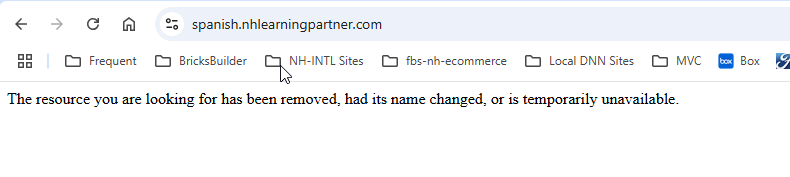

  6. After saving the change, the site tries to load and shows the screenshot below:
7. Checking the PortalAlias table, I see that both aliases for this portal ID have been deleted.
8. Restore those entries directly in the table. Check the DefaultPortalAlias in the PortalSettings table.
9. Restart the Application under Settings > Servers
I can now pull up the site again, English is gone, and I have access to the site under the correct portal alias.
