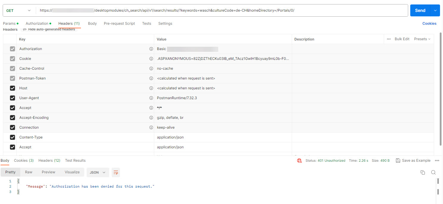

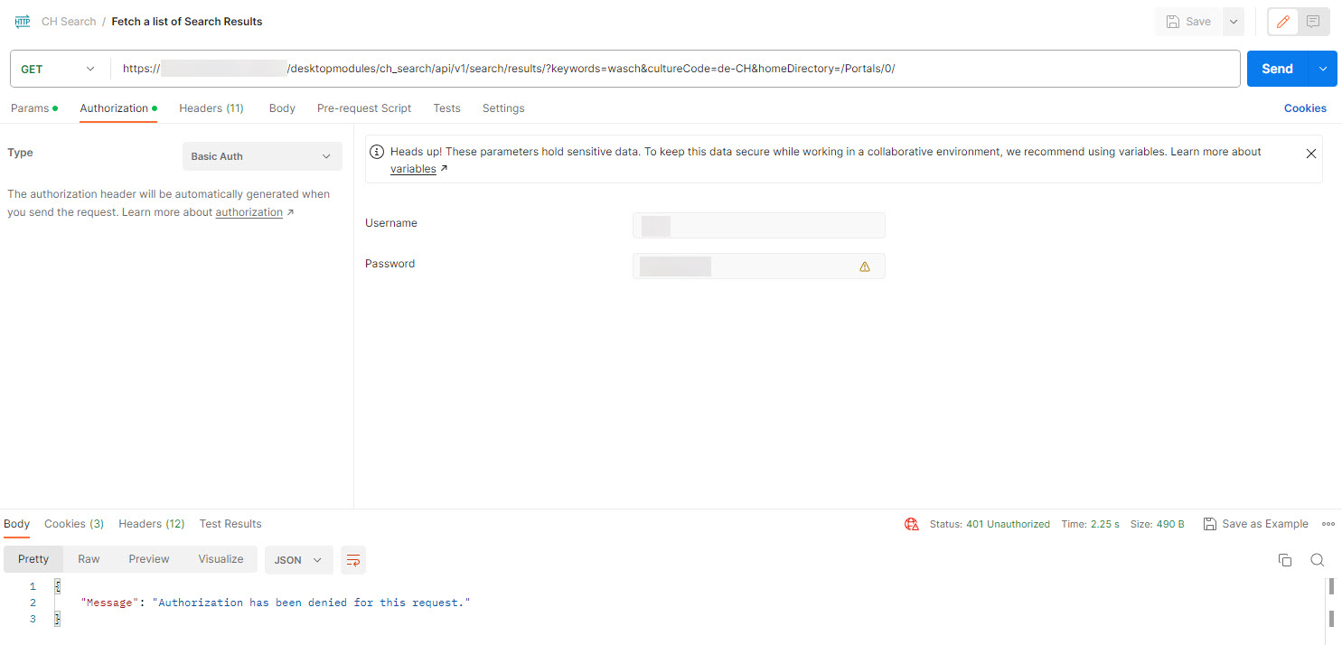

Are you sure you're successfully passing through the ServicesFramework and passing it in the header of your requests? That's what this sounds like. 🤔
Posts: 19
I think I'm doing everything correct because on my local PC everything works fine...
What exactly do you mean by 'passing it in the header of your requests'?

Maybe 2 screenshots from Postman can help you find what I am making wrong:
Postman_1
Postman_2
