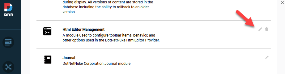

2 Steps
First go to Extensions and click the pencil icon

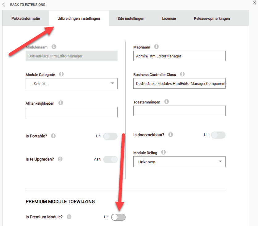

Than go to the second tab (Extension settings or Uitbreidingen instellingen in Dutch) and find the premium setting
In that same area, you can also specify which portal(s) (sites) you want to allow the module to be deployed on as well. 😎

It doesn't work in 9.13.03... no portals visible to set to "Unassigned" (left side)...
That means the module is available on all portals.
You can select a portal at the right side (portal name becomes blue) and click the double left chevron.
The portal will be moved to the left side. Hit save and all good.
