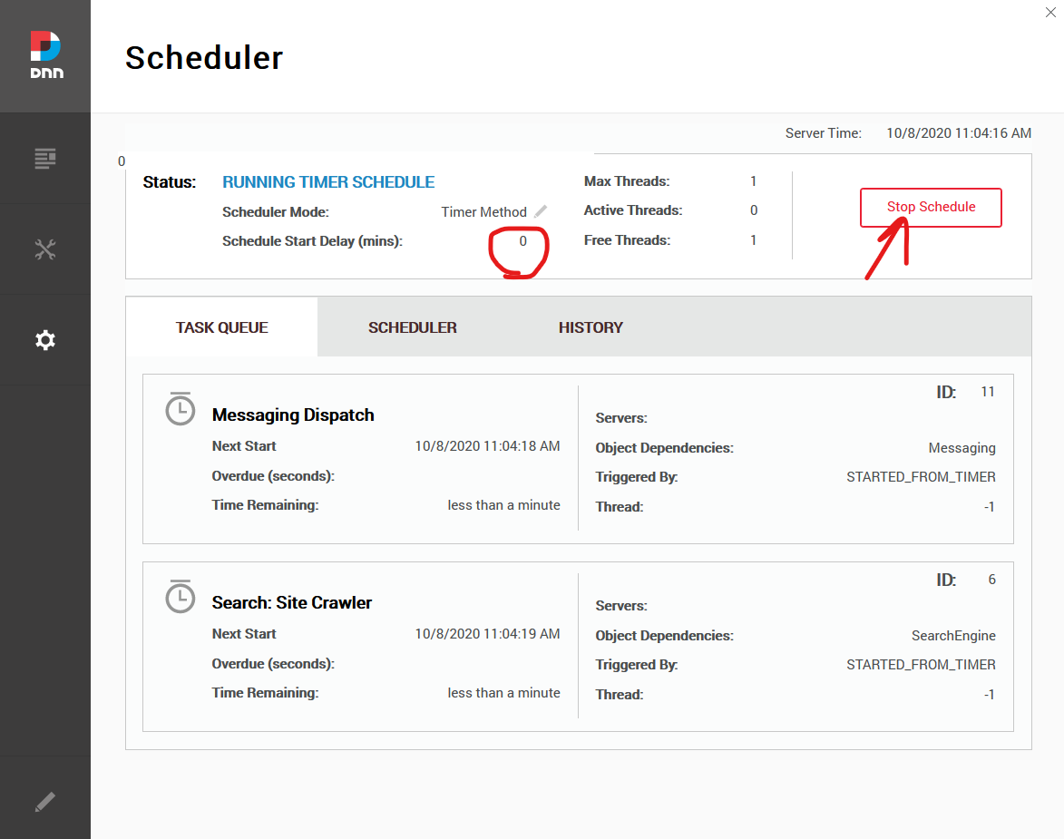

But It's better I ask my question like this:
You can see this image that It's New DNN 9.7.0 Installed on my dedicated server under Plesk hosting panel.
Scheduler was stop at the begining time and never start manualy also. when I change the schedule start delay from 1 to 0, then it's started as well. but now I can not stop it also! there is problem! this is my question, why not start before changing delay time and why not stop now?

I just logged in on the website and stopped the scheduler. There was no problem there.
** Edit: After a minute the scheduler starts again, so the issue still persists**
You could try change the value in the database. Either the time or the method.

Yes I check this new website, It's stopped! because other old website maybe issue that they never stopped!
What do you think? what is issue? where I should check to find cause to never start before changing 1 to 0 for delay field and why never stop after changing 1 to 0?  those websites are upgrade from older versions, some from 9.1 to 9.7, some from 8.4.2 to  9.1.1 and then from 9.1.1 to 9.7.0
Also there are several issue like problem in URL and etc...
but here I just need to find this issue.  but now started and working, and no need to stop. but, if we need to stop I think It should be stop by Database manualy.
