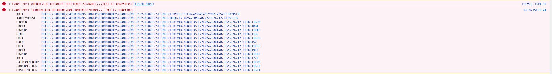

After upgrading to v9.0.0 from v8.04, the Persona Bar is not visible and I am getting the following error. Any ideas?
Thanks in advance for any help in this matter.
Andy
Posts: 1246
Are you using a custom skin. If so, is it loading jquery, or possibly a version that is incompatible with 9.0.0.
I'd recommend moving up from 9.0.0 to at least 9.3.2. If your modules are all ok for the upgrade, go to 9.5.0.
