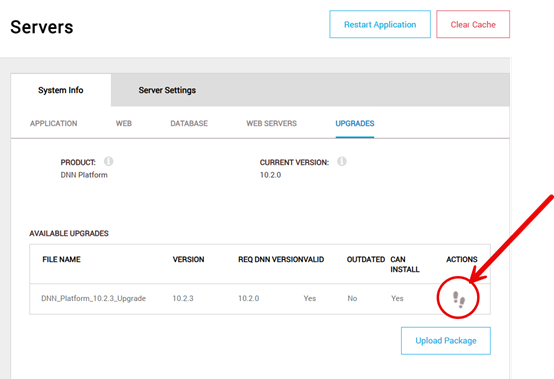

I see the same issue here. After I upload the upgrade package, how do you actually run the upgrade?
And what is the "feet" icon? Please don't tell me that's "run the upgrade"? laugh

Yes, you run with feet lol...
We should change that icon though to an UP arrow and add a tooltip. But it is the icon to start the ugprade.
Then you should see a message indicating it is preparing for the ugprade and that may show for some seconds or a minute, don't leave there. After it will redirect you to the upgrade wizard as before.

I don't have the button option to Upload Package. Any idea why? Can I still use the old method to upgrade by copying the folder?
Posts: 83
7 Helpful Replier
This issue is reported. See Issue #7069.
As a quick workaround, if you have access to the hosting server, you can download the DNN_Platform_10**_Upgrade.zip package and simply copy it into this folder [webroot]/App_Data/Upgrade/
Refresh or Clear Cache, return to the PB/Settings, Server, System Info / UPGRADES tab and you should see the upgrade as expected.
