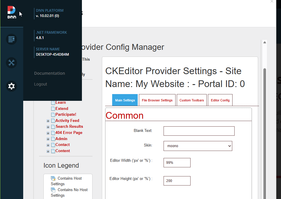

I can update that the upgrade to 10.2.1 did not fox the issue. I am unable to access the settings for the Editor, either in its usual place in Site Settings, or on a dedicated page with the HTML editor management module on it. The Browser reports the page as unresponsive. The Please Wait Loading Options message just sits there and never completes.

Yes and it made no difference. I note that my .NET Framework reports as 4.8.0. Any suggestions as to why?
