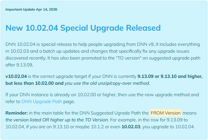

The New DNN 10.02.05 Special Upgrade Release
 4 Replies
 34 Subscribed to this forum
Posts: 83
7 Helpful Replier
Update Apr 22 2026: DNN v10.02.05 is now the recommended Special Upgrade Release.
GitHub Releases: v10.2.5
I am trying to help get the word out about the new special release of DNN that is designed to help make the upgrade from v9 to v10 much smoother. If you have questions, please ask. I'll do my best to make sure the easiest to find info is informative.
Please reply here with questions or suggestions. Or consider joining us on Discord with this invite. There is an #upgrades channel and MANY other useful and active channels with dozens of discussions, posts, and comments every week.
