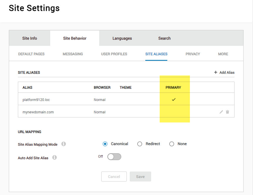

Be sure your new portal alias is also marked as the PRIMARY alias.  In the database, it should be the only alias for that PortalID that has a 1.  The rest should be false (0).  It's a BIT field.  Only those two values are possible.
