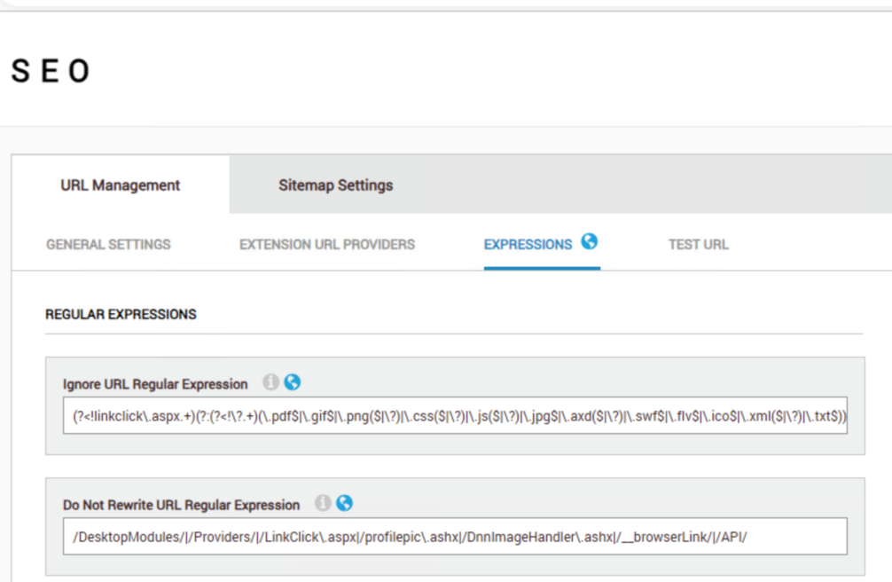

Why is DNN intercepting this request and how would you go about forcing DNN to ignore the URL so the handler can process the request?
Did you try adding it to the "ignore URL regex"?
Thanks, John!  I totally forgot about that setting!
Here's my updated code, just in case anyone else runs into this.
Original (ships with DNN):
<code>(?<!linkclick\.aspx.+)(?:(?<!\?.+)(\.pdf$|\.gif$|\.png($|\?)|\.css($|\?)|\.js($|\?)|\.jpg$|\.axd($|\?)|\.swf$|\.flv$|\.ico$|\.xml($|\?)|\.txt$))</code>
Updated:
<code>(?<!linkclick\.aspx.+)(?:(?<!\?.+)(\.pdf$|\.gif$|\.png($|\?)|\.css($|\?)|\.js($|\?)|\.jpg$|\.axd($|\?)|\.swf$|\.flv$|\.ico$|\.xml($|\?)|\.txt$)|\/system\/services\/&#91;^\/&#93;+\.asmx(\/&#91;^\/?&#93;*|$))</code>
Did it work?
Posted By johnhenley on 4/23/2024 10:21 AM
Did it work?
Yes, it did.  Thanks, John!  😎
